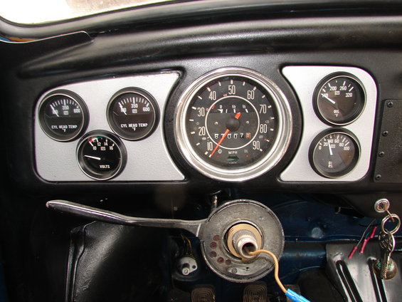

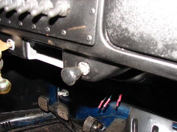

    working on gauges
    back side
    [​IMG]]
    should I paint the glove box door silver too or leave it black I am boing to be runing a silver and black MOMO wheel

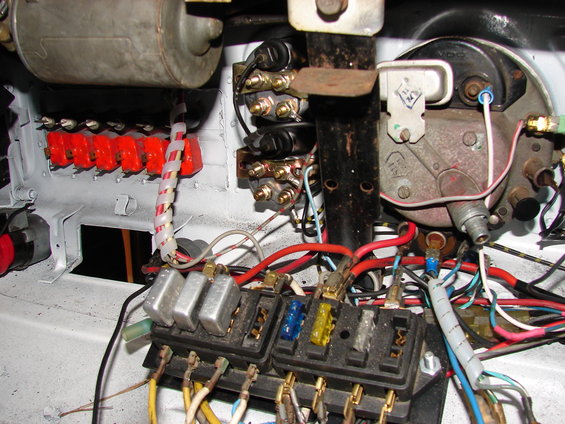

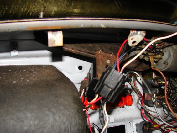

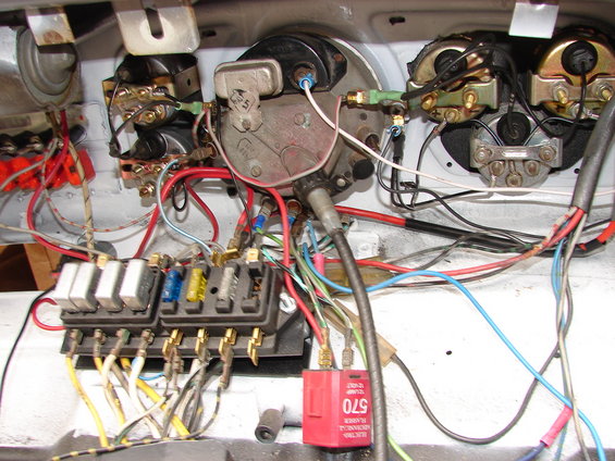

    Also working on changing out fuse box to ATO style fuses I modified the fuse box to accept circuit breakers for the headlamps will be adding a second box for lighting

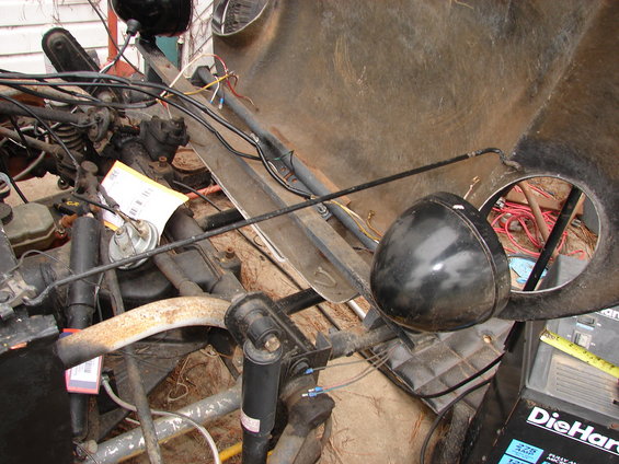

    and I found a prop rod to hold the one piece front end up
    and yes I an going to do away with crap headlamp mounting bar and make some adjustable mounts so I can center the headlamp in the holes

    Coming on real nice Carl, I think the glove box door would look cool either way, silver would give it a nice consistent look however. How much more work to do before its up and running?

    Looks good. How about an aluminum overlay for the glove box door?
  4. HuevosRanchero
    or a big chrome VW emblem on the glove box might tie it all together.

    All three ideas would work. Where'd you get the prop rod? Jose's beater Fairmont wagon up the street? A five-fingered discount?

    Actually pulled 5 or 6 different ones from a local yard cost was a whopping $0.00 If I remember correctly the one I used is from a Astro van

    The prop rod is a great idea. On the Bajas I have seen there is nothing to secure the open front clip and it is left to lean on the
    bumper or whatever is in it's way.

    Trying to stay away from aluminum the gauge pods were painted with Rustolem Hammer tone silver

    I really like hammer tone paint for projects. Looking at your wiring I get a feeling between nostalgia and relief that I haven't touched a vw for awhile :)

  16. ribald1
    You really should ditch those crimp splices and go with solder and shrink tube.
    A lot more reliable, especially if you take it off road where there is a lot more vibration.
  17. 5.0 Chero
    14,296
    Most all ready gone only ones left are turn signal ind lamp and fuel gauge wiring

    If I'm working on a customer's car, they get a crimp splice, as their desire (or demand, if you will) is that they have the car back "yesterday." But, if I'm doing my own work, it depends on amp load as to whether I solder or crimp. I know how to make very tight crimps, but some should not be made if there's constant current flow, such as in the ignition primary circuits or the headlamp feed. Just my two cent's worth.

    Generally I trust just twisting wires together with heat shrink over the usual crimp.
