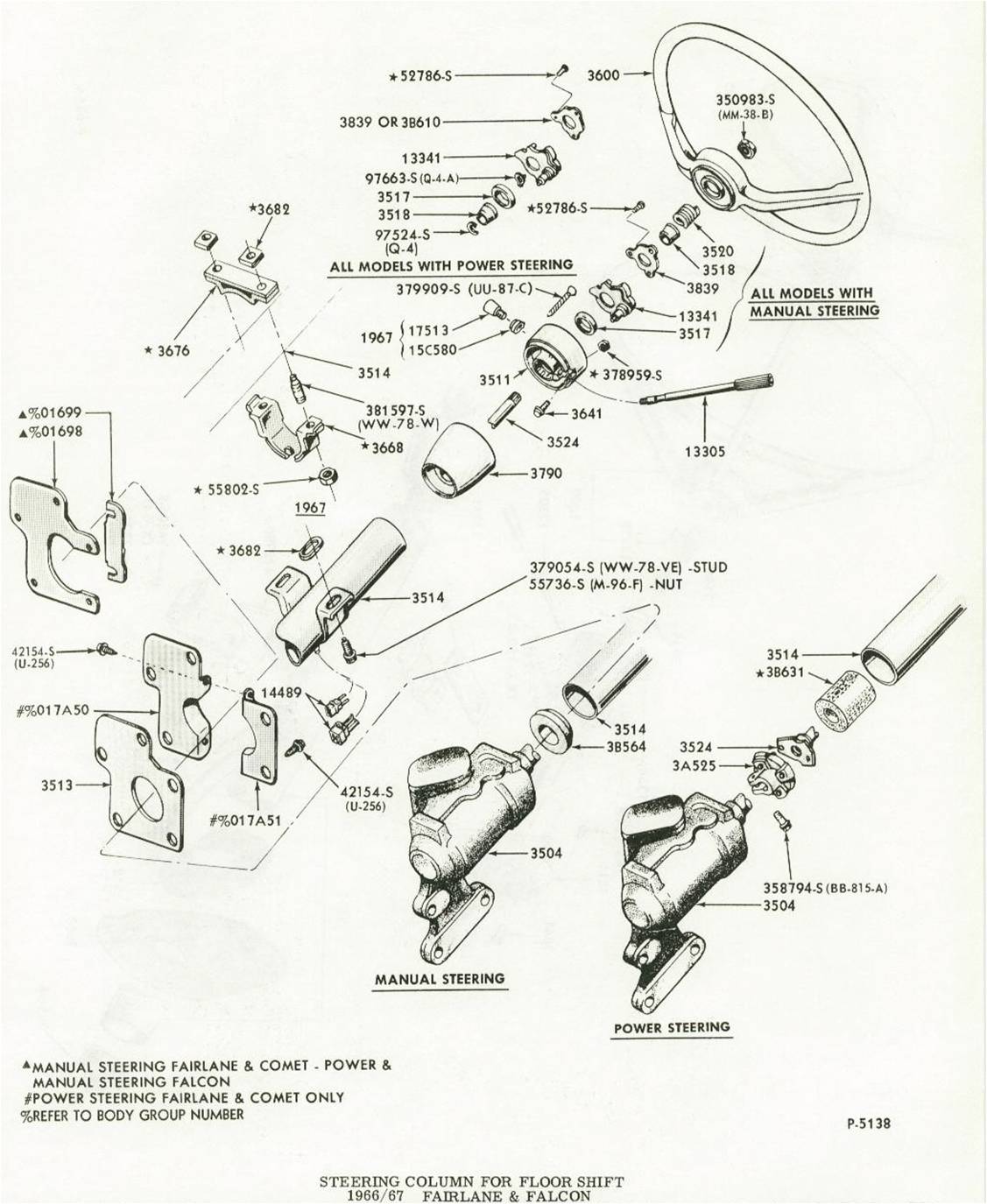

  16. 5.0 Chero
    His shaft is part of the steering box 2 piece shafts started in 67 or 68 I think it was 68 so as to keep the steering column from being an impaling device in the event of a front end crash,:eek:
  17. ribald1
    I've never taken one of those apart.
    Is it retained at the top and splined inside? I would imagine the shaft would have to be removed to pull the steering gears, so it should come out with the column in place?

  20. 72GTVA
    Might help, might not - closest illustration I could find in the MPC. 3524 is the steering shaft - follow the line from it to the steering gear...
