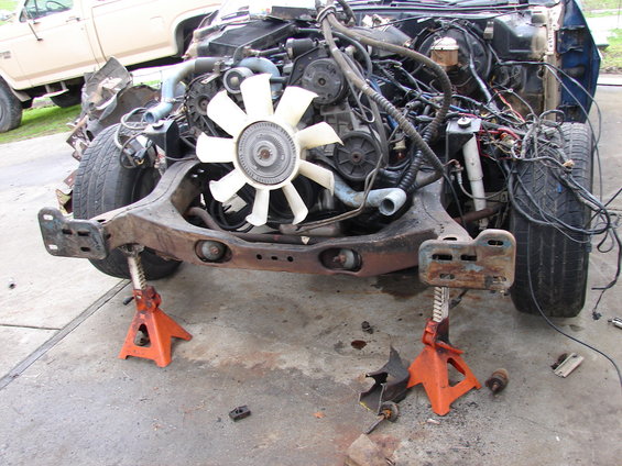

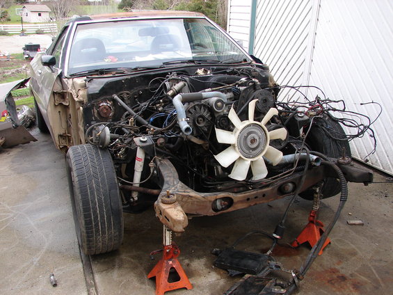

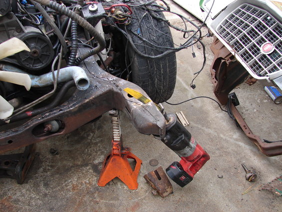

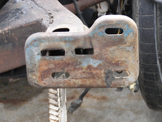

    you can "make it fit" but it will take a lot of fabrication skills fender mounting points are different, the frame horns will have to be modified to accept the 5 mph bumper I went the opposite way and grafted a 72 front clip on my 73 because I like the looks of the 72 better
    73 frame horns
    72 frame horns
    73 frame horn
    72 frame horn
