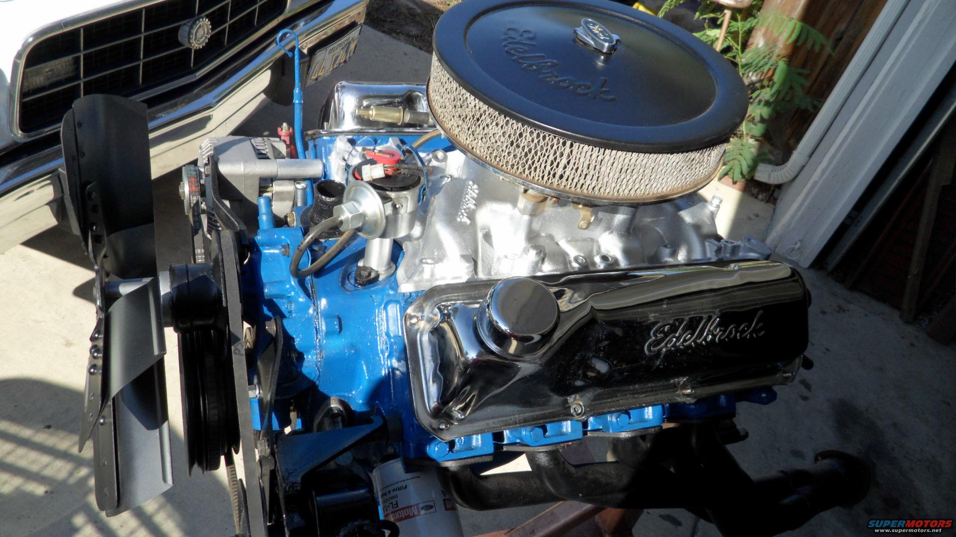

    Hi all. I'm not knowledgeable about cars but I'm trying to learn. But first I need to know about what engine I have.
    How do I know if its a 351c or other. Its a 74' gt.
    Thanks
    20240101_170658.jpg 20240101_170729.jpg 20240101_171045.jpg 20240101_171126.jpg

    Judging by upper rad hose position,valve cover bolts it appears to be 351/400 C/ M engine.Does rad,hose attach to block or intake?

    Yup, look at the valve cover bolts - NOT a 460, like LSChero said, either 351C/M/400M

    Oh gosh - please put a real air cleaner on that engine!
    I also see that your A/C still has the factory suction throttle valve. Old Air Products makes a bypass (part no. 50-2551) to replace that miserable piece of crap.

    with the "A" in the vin that engine "should have been" a 460. So looks like that may not be the original engine. Looks like the 351/400M engine.
    Buds 67 likes this.

    That's what I'm thinking. It stands to reason, you blow up your 385 series, you drop in a cheap 335 series, they bolt right up. You'd just need the specific 335 series brackets.
    Or, back when, it was a cheap way to source a 460 for your racer, and still have a shop truck.
