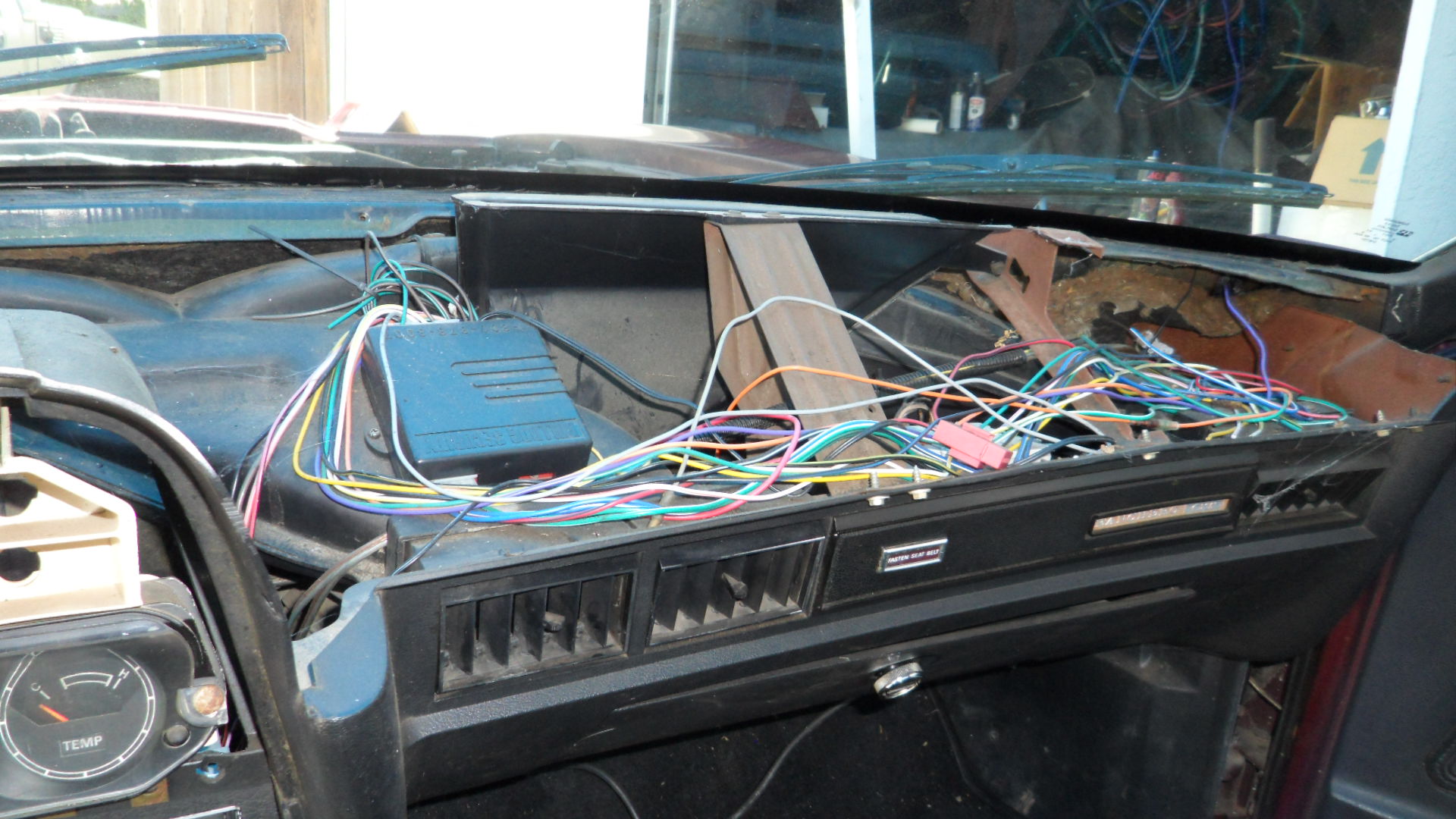

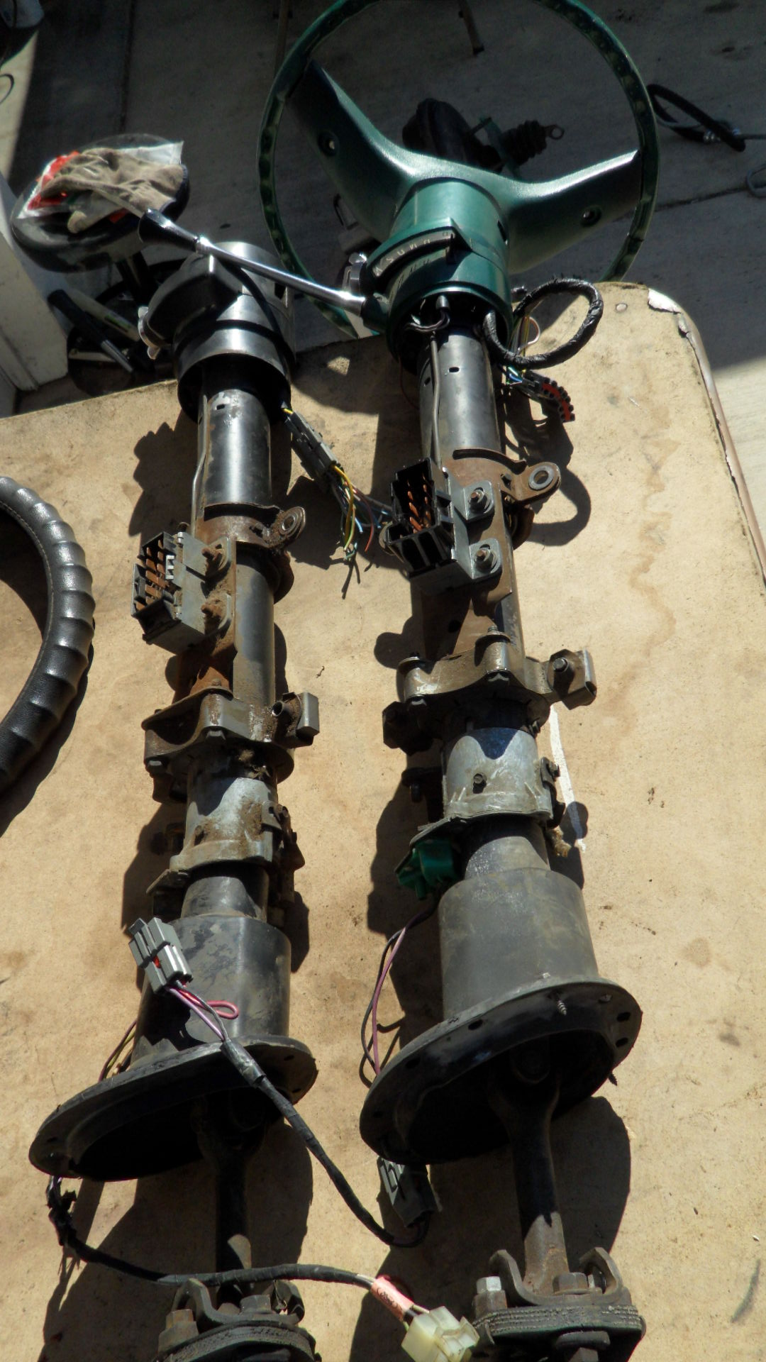

  4. LSChero
    72 colume on left,77 cougar tilt on right.Will have to swap ign. switch and NSS.
    This was under dash pad..almost called EOD!May pull dash anyway.Wiring is totally hacked +need to replace heater core.
    andrewok1 likes this.
  5. 72GTVA
    Oh wow! The good news is no original dash wiring runs up there... maybe that is just the stereo/amp wiring???
    Garbageman likes this.
  6. LSChero
    Bulldog security system,key fob,door looks,remote start and rude noises.
  7. 72GTVA
    Are you going to use any of that or looking to back it out?
    That is really a good looking car! Do you know the build date?
  8. LSChero
    Data plate not present on door,hopefully build sheet under seat.Not going to use alarm.You want it?
  9. 72GTVA
    No, no alarm, thank you.

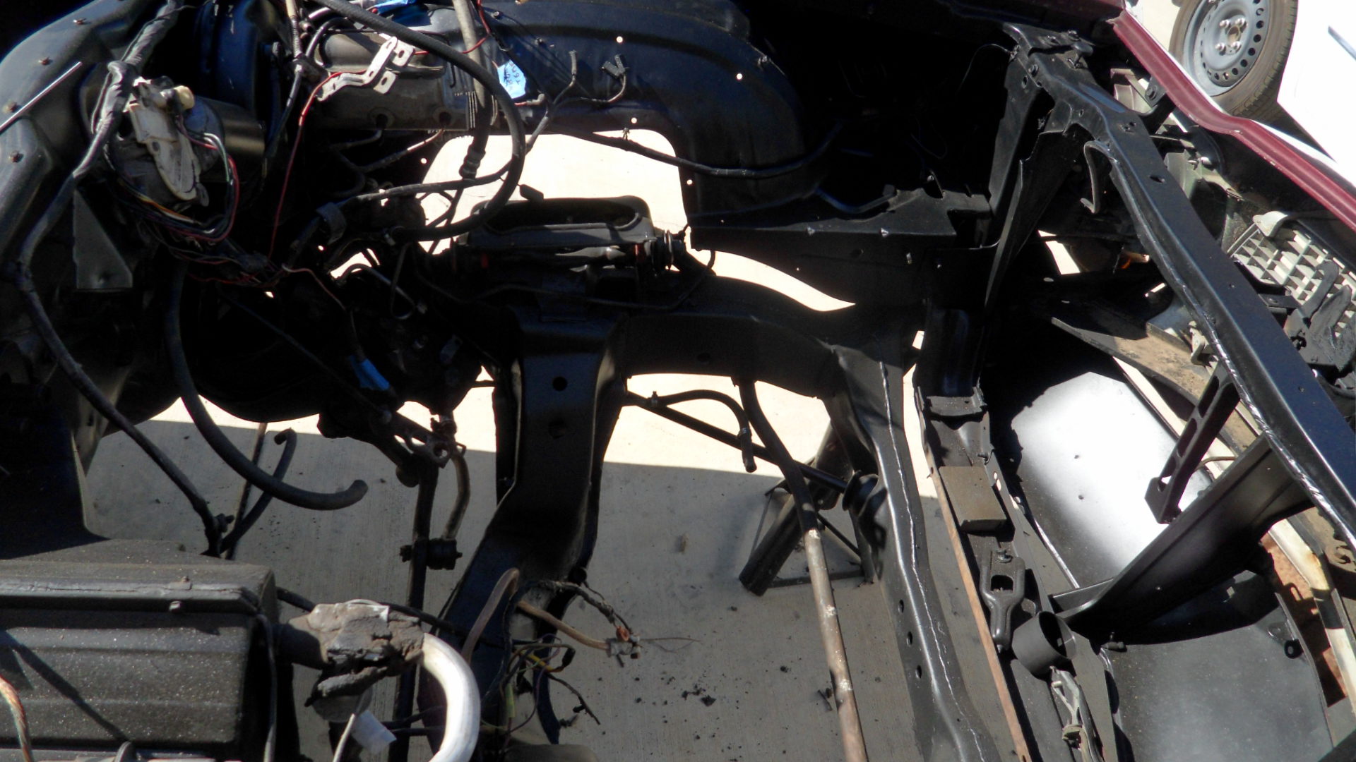

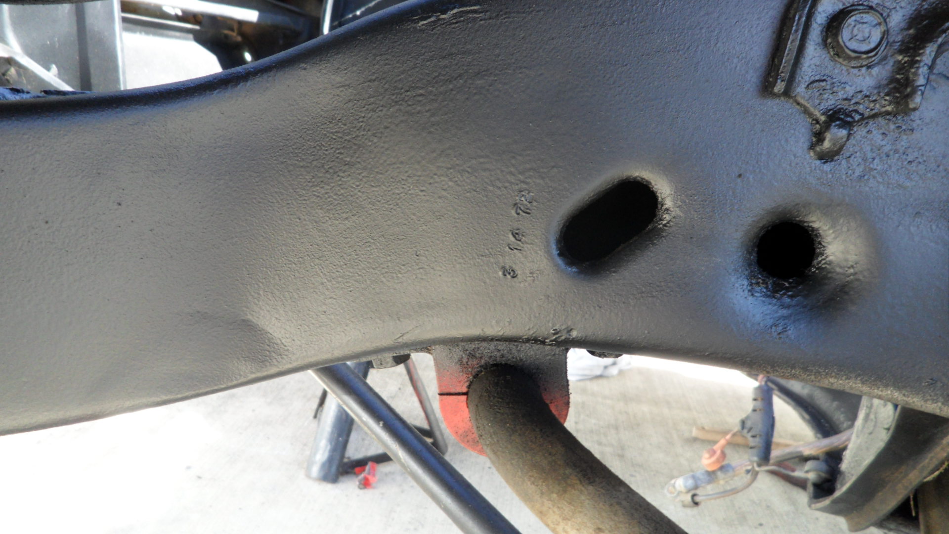

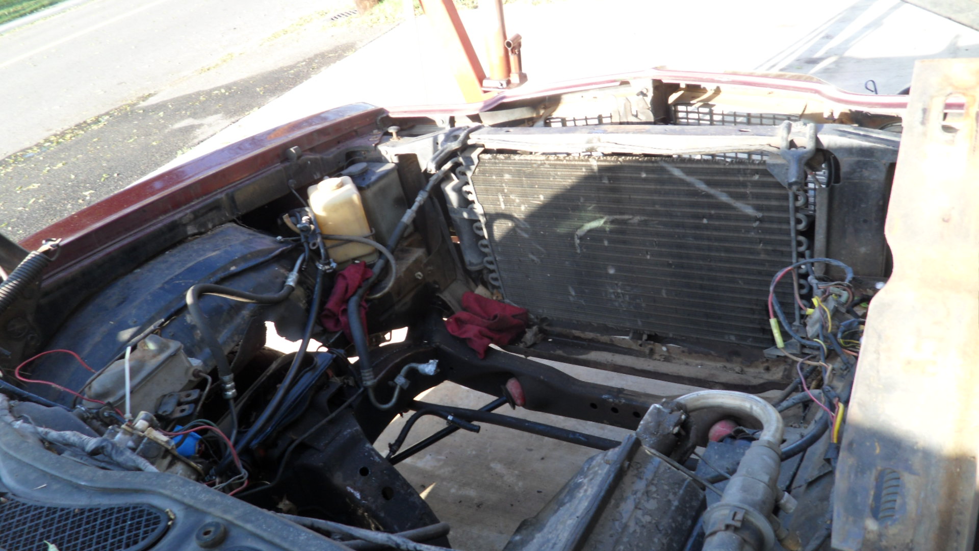

  17. LSChero
    After I pulled drive line,I detailed frame and engine bay.Hours of wire wheel /hand brush,scraper to get 42 years of road grime off of ranchero.Well worth effort.Sealed with primer and coated with duplicolor truck bed coating.Semi gloss on inner fenders.Still have back half to do..
  18. Jimbob
    Jimbob SITE SUPPORTER- SILVER GOLD MEMBER
    1,052
    Sounds like a lot of work! but looking at the results, sure worth the effort.
