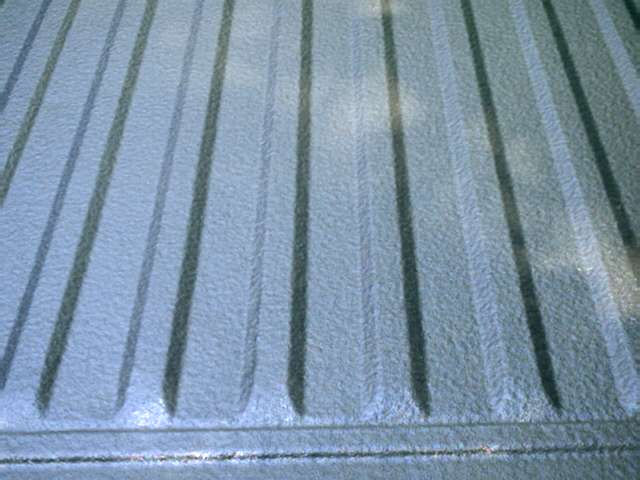

  3. HuevosRanchero
    Saving the bed from rot
    had a million dings and was used to haul cement...took 16 months to make it good enough for bedliner :eek:
    been a few years now...will redo when I get around to paint and body work...probably in white bedliner like I saw on AirFords daughters roundbody!
