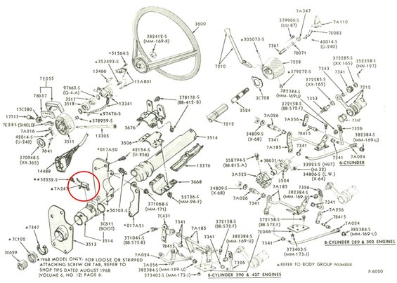

    On a C6 the neutral switch is on steering column down by the brake pedal. It has 2 small screws with a 5/16 or 11/32 head holding it to column.

    I have a 68 390 with a c6 and the switch is located on the column. The best thing to do is have a look at your car.
    If your car is like my 68 with switch located on the column then the one posted in the link is the wrong one.

    I did look at that diagram, and it looks to me like the switch should be low on the column, and visible in the pic I took if it was going to be there. Since the diagram is for a 1972 car, I figure there could be differences. Just thought someone might be able to confirm that.

    they sell bushing kits for the column/and FORD always had a better idea ,and changes where made often ,here is another view from fairlane

    Should be on top of the column, down near the firewall. Assuming yours is the same as my '71. Not very big, will have a connector with two wires attached.
    What do you suppose that hose clamp and plastic tie-wrap are there for? Possible they were holding down the switch and they have come unmoored somehow?

    Now that I have a better idea of what to look for, had another look.
    I think that you guys pegged it.
    Another angle clearly shows a bolt hole, and I would be willing to bet the quad connector, hanging loose in the foreground, that has been jumped with a green wire, should be attached to the missing switch.
