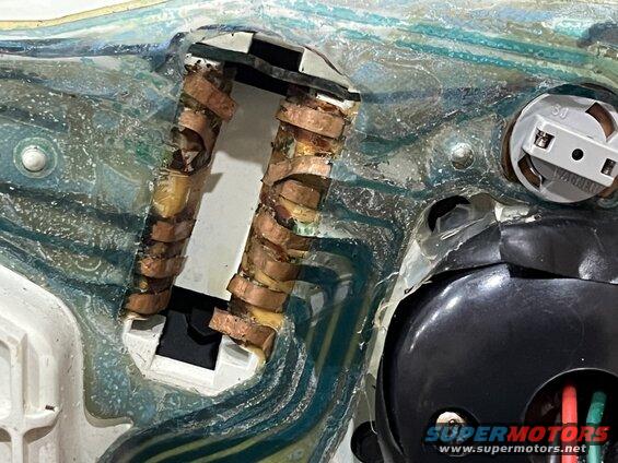

    Fortunately these have become available (from Neill in New Zealand). He has most years in both standard and sport versions.
    https://www.ebay.com/itm/284987161695?hash=item425a8efc5f:g:WKYAAOSwLiBgB-Yk&amdata=enc:AQAHAAAAsK7tb18Xg/ZAcFFvA+epUSf4U7l4Hf1LTfGYw0YUEGZnBfPMKuY/ZXl9AMqQtv9BIyqLkAiKvYfrM9HKri/AgY3xzlF0EThPzWAbI5rBGHSMEjCXQsT5ma9S4pzUZ9ulw3EAcdVZktsNadFvleLPcEa9+iGZTYqyEQ0VdhkxJXmqhjKBu/8uKtqFsjY/fHeTTvFTrGTkXOTVFdSUOhPTJpa2KEOoEGK5zU063pZDuG5r|tkp:Bk9SR4zazqfzYA
    Just pulled mine. Don't remember how many times I've superglued these tabs back into place. Looking hopeless. Hence ordered a new circuit board.

    ocala ,florida
    I just mailed your circuit this morning you should be in good condition after the new one is in place
    Andy

    Any chance you know the function for each of the 14 contact tabs? I would like to think one is a common ground.
    Anyway, I'd like to load mine with LED bulbs and I need to be sure the polarity is correct for each before I install the cluster.

  16. andrewok1
    andrewok1 In Maximum Overdrive GOLD MEMBER SILVER MEMBER
    3,973
    ocala ,florida
    Clark
    When your circuit arrives today as per tracking
    There is a lay out of the circuits electric path .. plus a color for the pin out of circuit. That should solve your Question ⁉️

    handy_andy,
    Terrific, LED's that are not polarity sensitive.
  18. handy_andy_cv64
    handy_andy_cv64 In Maximum Overdrive SILVER MEMBER
    13,888
    New Braunfels, TX
    Yup, the cluster and HVAC head have them. Although, the blue lenses are a bit thick, so even on full brightness, they don't shine all that well. Anyone do anything about those lenses to allow more light through?
  19. 1978GT
    1978GT In Overdrive GOLD MEMBER
    571
    Yes, ditch them! I have no need or desire to dim the instrument cluster illumination, so I made three modifications: removed the blue lenses, replaced the 194 bulbs with LEDs, and substituted the park & tail lamp feed (circuit 14, brown wire) in place of the blue/red coming from the rheostat on the headlight switch. I also added white faces to the gauges and repainted the pointers. Full brightness now.
